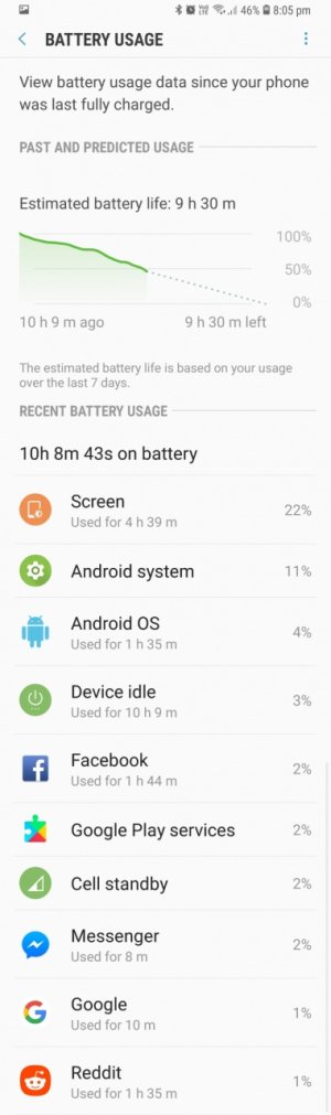

I've had my s9 plus for a little over a month now and it's been good but I don't know if I'm being paranoid but over the last few days it has been draining faster than usual. As I said 1% every 5 mins. I never have my brightness over more than half it still lasts me the day but it used to be it would drop 1% every 10 mins or 6%-%10 an hour. I don't put it on charge until prompted. I usually charge it early in the morning as it charges pretty quickly (I don't use fast charge). Sorry for the waffling. I have attached screenshot of battery usage

Yep Paranoid. Depends on what apps you are using when the screen is on for starters. How the phone is being used / CPU usage etc.
But your screen on time is excellent, as you have nearly 50% batt left, you're looking at ~ 8-9hrs screen on time! I usually get 5-6hrs total. When the screen is on its gonna drain the battery at the rate you are seeing, there's nothing you can do about that.
If you are saying its draining at that rate when the screen is off then there's something not quite right, probably an app running in the background.
Either way to monitor it get a better battery app, so you can see if any apps are keeping the phone awake/using CPU, like GSAM or Better Battery Stats.
Mine uses <1% per hour when the screen is off. And about the same as you (depending on what app i'm using) when the screen is active.
1% or less is pretty much normal. 2% or more is a bit on the high side, just means an app is running in the background, that could also be for a legitimate reason. Don't worry about it and charge it when you need too.
