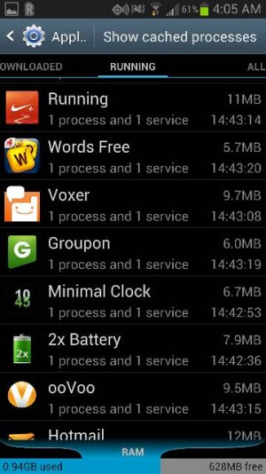

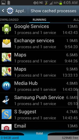

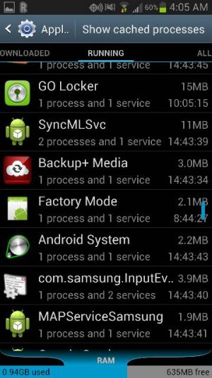

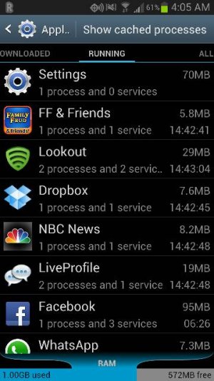

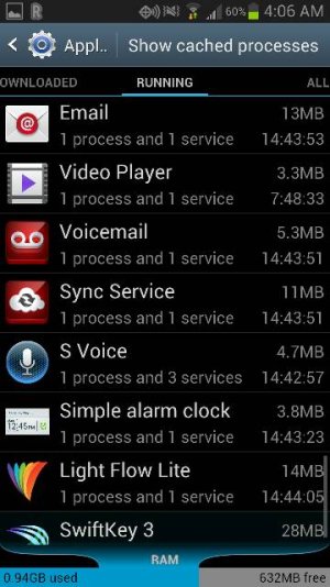

Go to Application Manager, then "running apps" and screenshot those and let's see what you have running.
Not rooted. I'm on stock JB.
Sent from my Verizon Samsung Galaxy SIII
On stock JB. And here is all the stuff I have running. There's a lot and I don't use a lot of these on a daily basis.

First thing? You use S-Voice instead of the Google Now Voice Search?
Also, looking at RAM at the bottom of the screen, you are using a lot it seems. mine right now is 477mb used and 1.1GB free
The Samsung Push Service, I have that disabled and numerous other "Samsung" named applications that came on the phone. I won't say that it has helped my battery life, not sure, but I didn't use the Samsung account at all, so I just disabled it.
Does Swift Key show up on your list under your battery much?
Also, is that "Sync Service" a Verizon thing or something from the Play Store?

The amount of RAM in use has no real impact on battery life. It all gets refreshed, all the time, regardless of whether it's "used" or not. Having apps in RAM is more efficient than repeatedly reloading them from ROM.
Anyway, I don't know what all of those apps do, but many of them sound like the kinds of apps that do background data updates. If you've got a dozen apps doing data syncing in the background, that can chew up a lot of radio use, and a lot of battery. For every app that does background updates, see what the syncing interval is. Unless you really need rapid updates, try decreasing the frequency, or turn it off completely (on an app by app basis).
And get rid of the battery save. There doesn't seem to be any evidence those things actually help.
I'd suggest using the "BetterBattery Stats" app, and find out what's going on with wakelocks and how much time your phone spends in various states. You should be aiming to increase your time in "deep sleep" state, phones that are using battery quickly typically don't spend much time at all in "deep sleep". At any rate, you can use that app to research your battery usage problems and find out which apps are keeping your phone awake. Then you can decide if you really need them and uninstall if reasonable, or look at changing their settings to see if you can't get them to sleep more. You have a lot of apps running, and any one or more of them could be keeping your phone awake.
