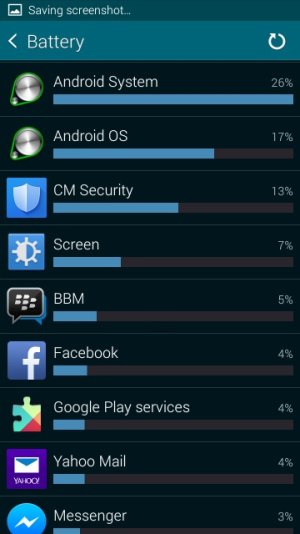

Go to Settings and Battery to see which apps are using the majority of the battery. It may be obvious from that but if not you can select the graph/chart to go to another screen to see some additional details. The thing that kills my battery is when my phone is struggling to get a mobile network signal and you can see that on the second screen referred to above. It doesn't happen often however. You can try uploading the screen images to here so we can have a look to see if it's anything obvious.
Also, I forgot to mention that it takes the longest time to charge, maybe 7% or so in an hour!
Include a screenshot with the graph on it and the second screenshot when you click on the graph

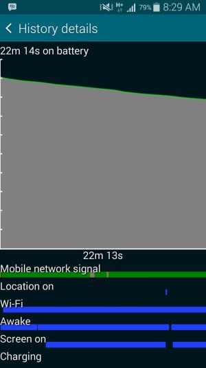

It happened again, have been sing the ohone for 30 mins. It was 90% full and it's down to 78% with just simple browsing and checking my email. No movie streams or music! Is this normal?
Wonder why it says screen is on high, I put it on auto adjust and it's usually very dim.
Its a bit difficult to say what may be causing the battery drain as the graph is only for a 22 minute period and nowhere near long enough to draw any firm conclusions. During that time though the screen was on virtually all the time and the device was "awake" for all the time (doing something in the background even if the screen was off) which are the 2 main causes for drain. The mobile network signal is fine though and not constantly trying to get a signal. I would suggest letting your battery drain completely until it powers off and then doing a full charge then repeat the drain and full charge once more. You shouldn't normally let the battery drain completely but as long as you don't do it every week then a couple of times is fine. You'll need to use a wall charger to do the charge otherwise I'll take ages. This should "condition" the battery into knowing what is flat and what is full and be able to better estimate your usage. Then just use it as normal and don't get too hung up if it drains a lot after using it constantly for an hour or so. A Motorola support guy told me about the draining and charging trick and I do it with every new device now. For info I get 2 days battery out of my phone but WiFi turns off over night and I'm a lightish user but you should be able to get a day no problem.
