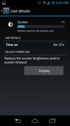

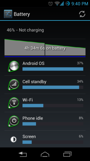

Sorry for the delay but here are the screenshots, even with barely any screen-on time the battery drains rapidly.

Now I'm curious. Try charging it to 100% again, unplug it and let it sit for two hours. Use better battery stats or equivalent to screen shot your partial wakelocks, kernel wakelocks, sleep vs awake, etc etc. Maybe it's because I'm exhausted and 12 hours into a 14 hour shift at 5am, or I totally missed something. But if all the batteries are doing this then something isn't vibing. There's more details waiting in better battery stats that could pinpoint what is going on. Some app has gone rogue or something. Do you have bad wifi? Bad network coverage? Facebook syncing every 5 minutes? Have you switched from a custom ROM...meaning has your battery been calibrated and is it truly charging to 100%? Just random shots in the dark at this point.
