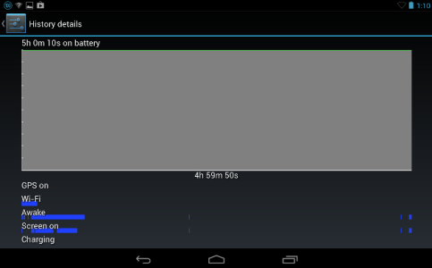

(on another note--I started having weird battery issues again, just a couple days ago. I'm actually having somewhat the opposite problem: it says it's 100% even after HOURS of screentime--and then it steadily declines a few % per minute. Attached are two screenshots in the same day, device was on a couple hours from 8 AM - 4 PM--I turned the device off which reset the usage, but didn't fix the "100%").
