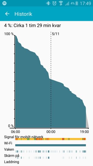

Lately my battery has also started to drop from around 15% to zero. Today it dropped from 21% to 4%, see image. Can it uploadfromtaptalk1446753258267.jpgbe because of fast charging? Does a new battery solve the problem?
Can anyone confirm that a new battery solved this issue? A few days ago I experienced the same issue and it occurred again last night so I am looking for a solution.
Lately my battery has also started to drop from around 15% to zero. Today it dropped from 21% to 4%, see image. Can it View attachment 204683be because of fast charging? Does a new battery solve the problem?
I'm having the same issue. I'm glad I have the Note 4 so I can change the battery. It sounds like a battery issue. Time to get a new battery. That is what I'm going to do.
Agreed. I bought a OEM battery and charger for cheap off amazon. Nice to have a spare laying around.
Ordered what I thought was an OEM battery on Amazon also but the reviews cast doubts as to their authenticity so I decided to return it for a refund. Went to T-Mobile to check if my battery was still under warranty, as it's less than a year since I purchased the phone. They ordered a replacement for me which will arrive in a few days. Hope this solves my problem.
