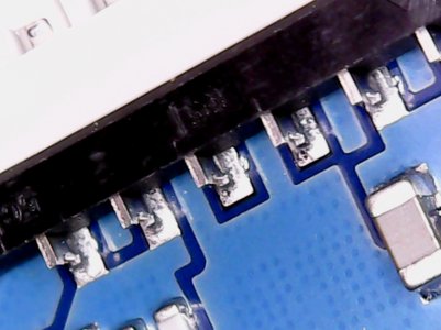

Your battery connector is barely connected to the mainboard due to cracked solder joints, battery's capacity jumps up and down is an obvious sign of loose connection, just like your lamp connected to a loose power outlet, it's on and off depending how you wiggle the power cord.
This is a flaw in most of Samsung tablets, the bigger screen size, the more like it has cracked battery connector but inspect the battery connector to see the crack is beyond the scope of most average users: most will see it looks normal like this one. However, it will move if gently push.

Believe me or not, it's up to you. This kind of problem from this tablet, I have fixed not one but over hundreds of them, I just try to guide you to the right direction, not guessing solutions you'll see from other experienced users, know what to do with software problems but no real experiences how to fix or troubleshoot a hardware problem correctly. Let you experience with all advices you have got and you'll see which can help you to fix your problem.
I see many users stubbornly believe it's software problem and try all the magic to fix a broken connector.
This is an example, how a Samsung tablet can have a false reading of battery: disconnect your battery, connect your tablet to a charger, within 10 seconds the display will show the full charged green battery icon ( 100% ) as no current draw to the battery connector, the charging circuit thinks the battery is full.
This is the same with a cracked battery connector which has intermittent connection, one moment battery has 45% and the next it drops to 0%.

Don't be mislead by repair statement from Samsung repair center, they only report what parts are replaced in order to charge back to Samsung.
Repair centers are contractors who provide services on Samsung behalf and parts are supplied by Samsung. Battery drops from 45% to 0 is not related
to charging port, a rework or resolder is not a part, that's a reason it's not included in the repair statement sent to customer.
Every tablet returned to service under warranty, a repair center will replace anything is not full working condition regardless to the main issue.
Samsung or any other companies will never let a customer know what they did to fix a flaw in their products in a repair statement.
So don't expect Samsung to tell you they resolder your battery connector to fix the problem of quick discharge or anything related to battery issues.What a technician did in details usually is not sent to a customer.
