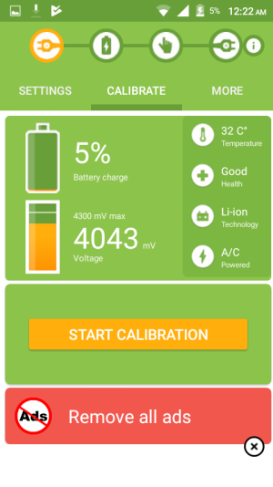

Recently my phone dies and charges to fast. I notice that it doesn't charge properly.
The battery percentage just skip the 71%-99% when I charge. And if I use it, starting from 100%, it'll kinda fast drop in a few mins, and as soon as I reach 35%, it suddenly drops to 0%. I plan to remove my battery but i can't cause it's unremovable. I also tried Battery Calibration but ends up in failure. I check some apps (Battery Calibration and Geekbench) and it says my battery's health is good. So why is this happening? Can I fix it? Using lollipop 5.1. Want to send pics of battery consumption but I don't know how to post.

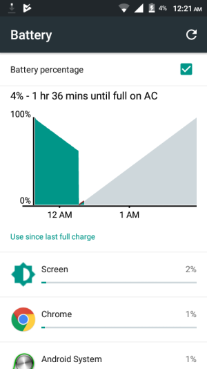

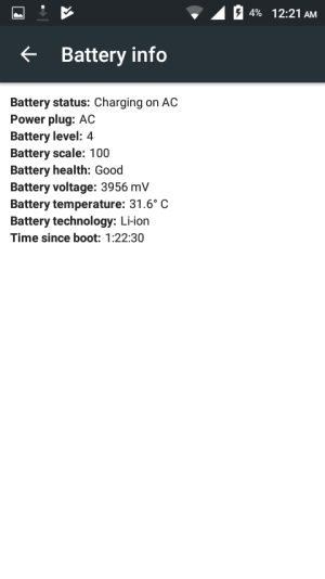

Now that I am able to create a account. This is what it looks like.
Bought this phone just a year ago. Not expecting this Battery problems to come out early. Battery doesn't look like it's expanding.
