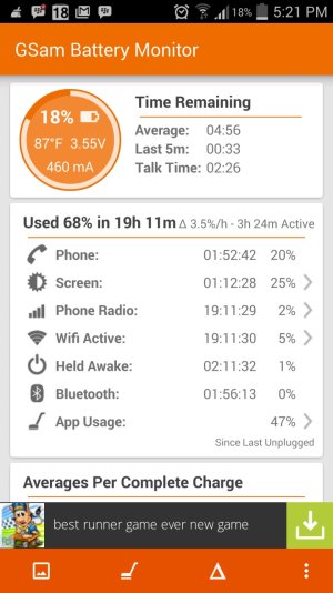

I have installed GSam Battery Monitor and these are the screenshots for the first charge. I barely used my phone, I charged it in the evening, checked couple of tweets and messages every hour or so, but then I left it alone since I was sleeping.
I included the wakelock screenshot - there are some that are apparently eating at my battery.
Do you think a system cache wipe would resolve the problem? A restart, or power off and restart doesn't change anything, and I'd like to avoid a factory reset.
