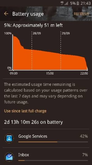

My standby time went from frustrating to glorious, I found out another thing by accident when I went on a camping trip I forgot to turn my phone off, it lasted more than 2.5 days with 4 hours SOT, Doze, Greenify and WiFi off were the best combination, check the screen shot for the results.

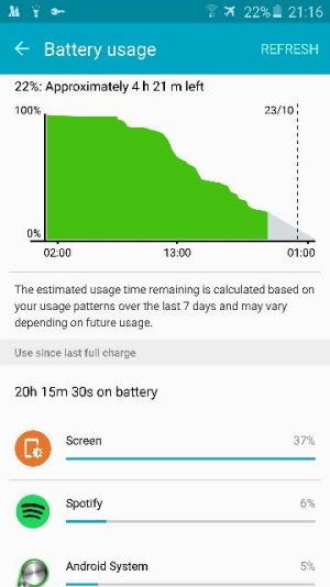

Managed to get 20 hours before I had to charge due to work the next day but would have been 24. There are a few things you can do to get better life out of your s6.
1.To start change from touch wiz ui to nova laucher or similar.
2. Go to applications and disable any app that you do not use regularly or just delete all together.
3. Enable developer options and change animations to quick. This way your s6 will not use system memory and power making all these animations loading apps which are really pointless as you just want a be able to open a app.
4. Download oprea max from Google play, opera max sends data to a VPN and compresses files this way it will load faster you won't use as much data and your phone won't spend longer loading large files. Also you can disable apps from syncing in the background that you do not use. Cut out that junk you do not need.
5.use dark backgrounds and download a simple icon package that is minimal. Not a must but found it helps.
Hope this helps :)

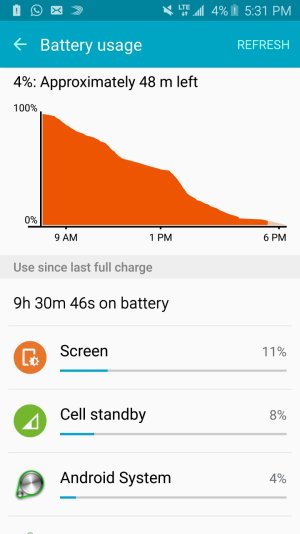

I can't find a general battery thread...so hopefully I can hijack this one for guidance.
I can't figure out what happened to my battery life. I used to go to work with a 100% charge, come home, go to bed, and wake up in the morning and still have a charge. I don't need it to be that awesome - but now I can't even last a full work day, even in power saving mode. :(
I've also got a screenshot of Android System and Google Services if needed...I'd love some feedback on what's killing my battery, because I don't really understand it.
