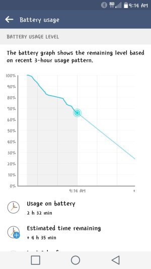

I have an LG-G4 and in one very specific location (my cabin) I only get about 3 hours of battery life (when not in use) when I have anything higher than GSM Only selected as the Network Mode. I have been in contact with Rogers and they have replaced my phone and I am still experiencing the same issue with the new phone. The troubles started when I upgraded to Android Marshmallow. Rogers has checked the cell signal and do acknowledge that the signal is weaker but should not cause this sort of battery drain. I had an LG2 and my wife and daughter both have an LG3 all running KitKat and have not experienced this type of battery drain at the same location.
I tend to think it's because it's constantly looking for that signal. I notice in outlying areas that it will cycle through 3G, 4GLTE, and sometimes 1X and it gets very warm doing so and drains the battery a lot more quickly.
here is a screen shot of the battery life. Note the flat spot, that's when I switch to GSM Only, the rest of the time it's on the other network modes as I cycled through the options

When your signal is low the phone power has to be increased to keep a stable connection. Lower signal phone radiates higher power.
Based on your screen shot, I'd recommend you switch away from LTE mode: settings, more, mobile networks, network mode, select GSM/WCDMA auto. Try that for a day or so. If it's still draining, switch to WCDMA only. Try it for a day. Still draining, switch to GSM only. I was having poor call quality at my home (one, maybe two bars) and switched to GSM/WCDMA. Now I have 4-5 bars and call quality is much better.

I researched the Bell cell towers in my area (Canadian Cellular Towers Map) and found that the closest tower does not support LTE. Even with the Weboost cell booster, my signal strength did not improve. Once I switched my phone to GSM/WCDMA, signal strength improved (as did battery life, about 2 days between charges). I no longer use the booster.
