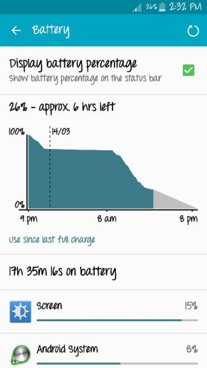

now that i have lollipop,i had another software update while i was using lollipop and i tried downloading it but it says update has failed so i tried checking under about device>software update and it says latest update has been installed.now i think it has impacted the battery.standby can drop up to 6-8% and battery drops faster than normal while i am using it.tried clearing cache same result
will post stats when reach 20%
thanks!
here are stats notice that it was only 17 hrs off charger
edit:when on idle,battery drops quite fast too

I'm like B Diddy, how's your cell signal that can really make an impact. when you're at home are you on wifi and does your battery stay up pretty well while on WiFi?
i use wifi at home and sometimes i put it on flight mode when there is no signal or when i dont want interruptions but my battery goes down quite fast compared to KK i dont want to reflash KK but lollipop uses battery fast even camera it can drop up to 5% just by taking about 15 minutes of pictures
with your phone draining like this it could be a third party app acting up in the background.
one thought check your sync'ed accounts see if one of them is locked up constantly trying to sync.
I found out the problem it's Facebook thanks for the help now lollipop is good no lag and has great battery life thanks m8
