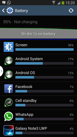

hi guys, any suggestion on my battery life?
Seems to be finishing really fast that i have to charge it everyday.
I only uses WiFi for whatsapp mainly. It finishes around 9 sth everyday
Re: Battery life on Note3
you need to run it down more, and post screen on time (> 2 hrs) together with usage list. At a glance, 5hrs, 15%, thats 33 hrs total and not bad.
You have got to be kidding. Screen on 36% of 5 hours and at 5 hrs you're still at 85% left. That's well over one full day Just how much battery do you think you can get out of one of these things?

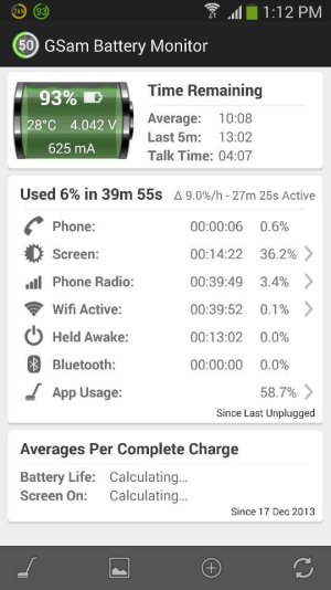

please guys help needed !!
when i full charged my battery on note3 and installed the app `gsam` it shows the battery 625mah while isnt the battery of note3 3100 ma.. i just want to ask what is this thng im confused !! please help

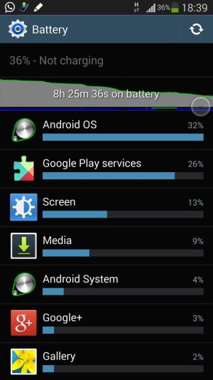

I have a similar but worse issue with my note 3.
Before this my battery life was just great. I'm using the international snapdragon version of the note 3.
A few days ago i was prompt to update the phone for some stability improvements. After doing so my battery life drained much quicker, and the phone gets hot when I put it through some multitasking. ( It didn't heat up at the time before the update.) Now my baseband version is N9005XXUDMJ7. stock touchwiz android 4.3
I've done a factory reset and yet this issue still persists, never downloaded any new apps after the update. Everything's the same.
Screen on time is 2h 9mins at 36% battery life.
Please help me =(
I'm not a battery expert nor EE, but think that the Ma value represents current flowing at a given point in time. My Note 3 shows 450 mA, @ 3.906 V at this point in time. I also have a 3100 mA battery.
Please help me =(
I have had this problem and I don't think it has anything to do with an update. Install wake lock detector, enable the system information from the application menu, and let your phone alone for a while. If you see that your phone is awake for more than 10%, then you have a rogue app not allowing the phone to go into deep sleep. Understanding which app is causing the problem is not necessarily straight forward, I would recommend not using the phone as an alarm, disabling location reporting and history from Google settings and uninstalling Google keep. That did it for me. I have great battery life now:
As you can see in the image above, I did get the problem for a while, to the point that it managed to consume as much battery life as the screen after six hours of use, but I still got close to two days of battery. Pretty amazing, I love this phone!
Sent from my Samsung Galaxy Note 3 via Tapatalk
