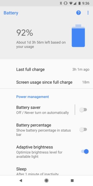

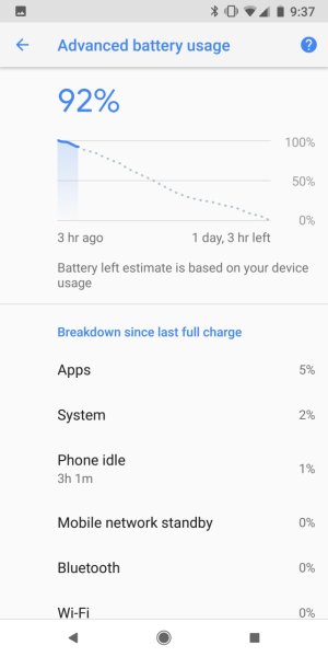

This really seems bad. Brand new phone (less than one week) had great battery until 8.1. Please take a look at these screens from this A.M. Charged to 100% 3 hours ago and limited usage. Does this seem reasonable?
In my web search I saw nothing in any type of info regarding the 8.1 release and battery calibration of any kind. Lots of complaints tho about batteries draining and curiously the standard checks and fixes regarding rogue apps and the like. Facebook was mentioned as a culprit.
