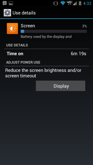

Ok, so I've got the Bionic and have been having some ABSURD battery life. I cleared the cache a few days ago and that seemed to help for a couple days, letting me go all day and still have battery to spare at the end of the night. But today, I didn't even make it through the day... here's some screenshots I took of my battery usage, any help would be great!

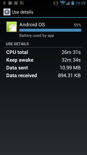

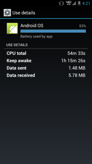

I have the same issues. I leave my phone alone after charging. I even have smartactions turn off the network. After 2 hours I come back and I'm down to 80%. When i look at the battery usage it shows:
I'm concerned because the uploading number is so high. How can I figure out what this is or better yet stop it.
thank you
