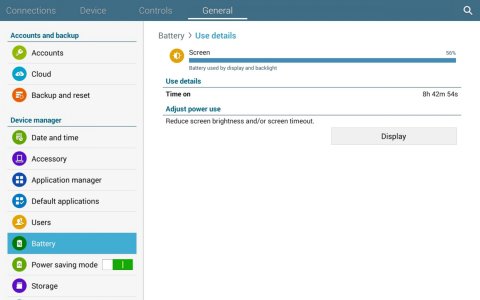

So, I charged my battery to 100% last night to do a battery test this morning. I have all my notification options off except for wifi, reading, and power mode. I used the battery guide posted for the 10.1 http://forums.androidcentral.com/sa...-life-how-youre-being-robbed.html#post3248366 I used this youtube video https://www.youtube.com/watch?v=R0x7ZsTioCQ This video is supposedly in 1080 hd. and these are the results I got
If I double that I would get around 8 hrs and 20 minutes or so. Something wrong with my battery? I'm on power save and auto brightness. That's 8 hrs and 20 minutes screen time i should clarify;.

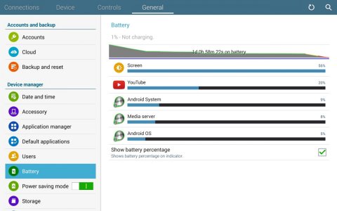

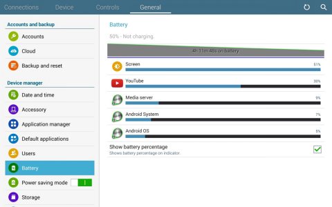

Well that answers that. I did notice that 30% was for you tube and I believe that the you tube app uses more battery than using you tube from the web. I'm not sure about this but I think I'm right.
Yea. I was keeping everything minimum so I could get a good estimate running only the youtube video. Do you think the more time I use the tablet the battery might "settle in" and get better or am I just typing nonsense. Thanks for the help btw.

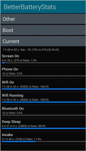

Update: it appears as though on standby I am seeing a drain of about 0.04% per hour. The tablet deep sleeps very well.

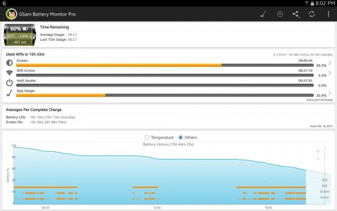

It's just curious because I'm reading peoples battery life on xda Note 12.2 Battery Life - xda-developers and some people are getting incredible battery life, the type samsung is saying you should get to. Like this guy battery.jpg while another person said they are able to stream from pleax and only lose 20% battery. But if I'm not satisfied I will exchange it at amazon and hopefully the battery life will be better.
What exactly is incredible about that screenshot? Seems to me that it's 6 hours of screen on time . . basically . . If you look at the bottom graph you have a history of 15h44m, and in that timeframe you see these long plateaus on the blue graph where when you look below them at the bottom the screen/wifi bars indicate that both screen and Wifi were off during those times too. Essentially during those plateaus the tablet basically completely in deep sleep which is why they're so flat.
Edit: The difficult thing about reading these charts is that they don't give a complete idea of what the usage was like during the steep downward trends where battery is draining rapidly. On cell phone charts sometimes you'll see cellular signal strength indicated as low/weak and the drain will take a nose dive due to increased power requirements. On this chart you see screen is on quite a bit and wifi is on a lot as well, just not the full 15 hours. What we dont see is how much processing is being done and by what application. For that I had to go into the other thread you linked and pull up the application list associated with the battery drain chart. From that I summized that the reason battery life is so good for this person is they are not doing anything really intensive. The top ranked applications are all things that wouldn't be pushing CPU speed to max power. Things like Google Play Newstand (reading application), Facebook, Tapatalk, Chrome, and Messenger are all things where you won't see it running at full clip for an hour straight. Without a CPU state report for the same sample duration there's no way to know just how far these applications pushed CPU speeds up and for how longh though so we'll never know. If the YouTube application was ranked #1 on that chart, he still had seen 6 hours of screen on time and had the tablet on battery for 15 hours then I'd say thats great battery life. Again though, I could sit in youtube for 6 hours just tapping the screen without playing anything and make it the top ranked application in battery stats without pushing CPU very hard (though I'd run out of patiences after several minutes LOL!). Point is, there's TONS of variables.​
