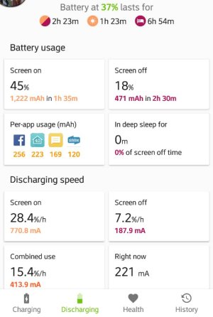

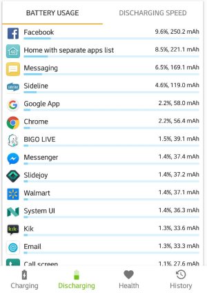

Yup, that's excessive usage and no apps jumping out.
I notice that your screen was on for a lot of that time... what is the battery like for a period of time with screen off?
Do you have a lot of widgets in place?
Are you willing to list the apps you have installed and their purpose? I know it's a pain, but it would help diagnose.
Have you tried booting into "safe mode" to see what battery life is like without your installed apps?

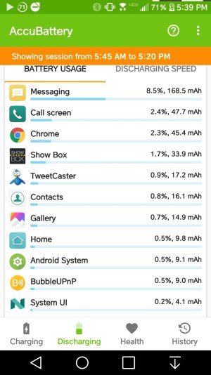

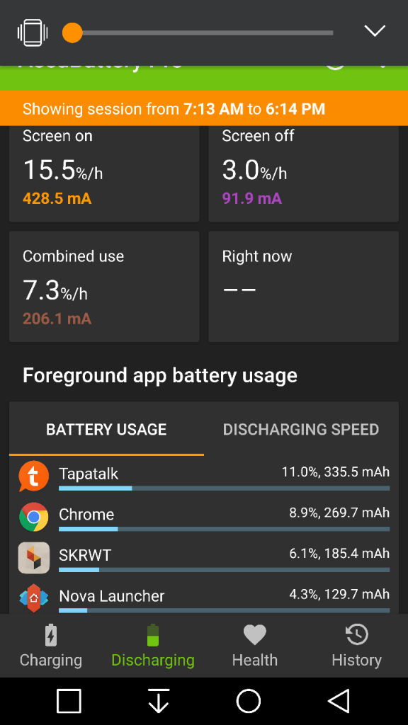

It looks like accubattery and the stock battery monitor are showing different readings on what's draining the battery.
