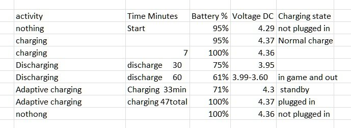

Does anyone have some real numbers to back up anything they are saying here?
Get a data logger and plug the phone in with a dead battery and charge it up and draw the data points.
I had actually done this manually and the results are in the table attached. I really don't think anyone needs to worry about leaving the phone plugged in even after the phone tells you to unplug the charger. The battery life is not going to change "very much" by leaving it plugged in overnight. It is a $30 battery and an $800 phone, think about it from the correct prospective. See attachment #2 for my professional opinion as a communications and electronics expert. Trust me, it will be fine.
