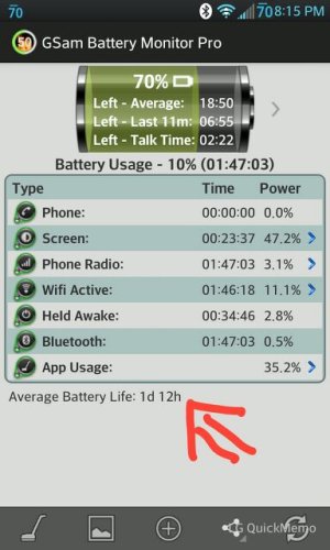

I recommend Gsam battery monitor, but that's because I'm the author :) Better battery stats does a great job as well. A simple app like cpu spy will also show you how long your phone spends in deep sleep. You want this to be as high as possible.
On my Sprint lgog, I get 36 hours average on a charge. Not too shabby...
Sent from my LG-LS970 using Android Central Forums
I will check it out.. im currently at 79% and its been off charger for 4 hours.....will not even moderate use.
Love the app.
