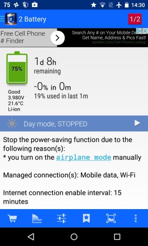

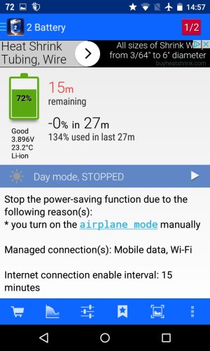

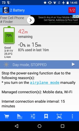

The attached screenshots show the problem, does it tell us anything?. At 14:30, there was 75% and over a day of life remaining. By 14:57, still 72% but now just 15 minutes remaining. Voltage and temperature seem OK. What does this mean: "-0% in 27m, 134% used in last 27m"?

Sorry, but I can't explain those readings. I would still suspect a failing battery, but of course I would understand how opening the phone up and replacing the battery might be a last resort.
