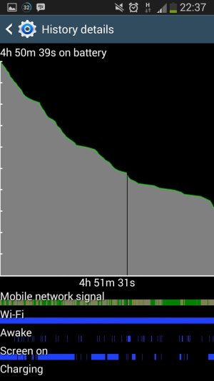

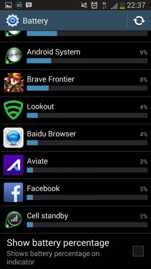

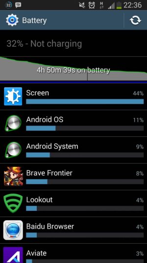

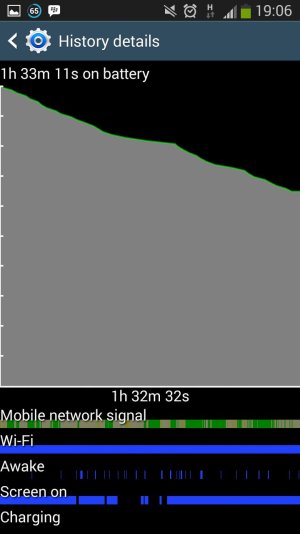

Hello! I just want to ask is this considered normal? It just draining to fast for me, and when playing games that need connection my phone becomes quite hot.
Thank you so much.
For info, my phone is rooted, already tried factory reset, charged by samsung original charger (with htc cable), and a brand new battery (maybe 2 to 3 weeks since first time I charge it)

The first series of screenshots (where the battery is at 65%) is much too early to allow for useful analysis. If the need arises in the future, be sure to let the charge level drop to around 30% (as you did in the second set).
Unfortunately you did not include one of the most important data points - you need to include a screenshot of the Screen On details. It would also be helpful if you mention where you keep the brightness level: the brighter the screen, the more battery will be used.
In the History details it appears that you had Wi-Fi turned on the whole time, but you weren't actually using Wi-Fi - you should turn it off if you're not using it, as that will save some juice.
You can't really tell what your Mobile data signal quality is like (unfortunately the icon doesn't show bars or anything similar, and I'm not aware of an app that allows you to track it) but just be aware that Mobile data uses the most power.
Finally, you mention that the phone was getting hot - that's generally not a good thing for any kind of electronic device. I realize that many games tax the CPU and GPU, so if possible you should turn off other things that draw lots of power (like Wi-Fi and/or Mobile data) to help reduce the heat debt and power consumption.

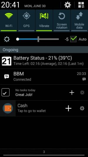

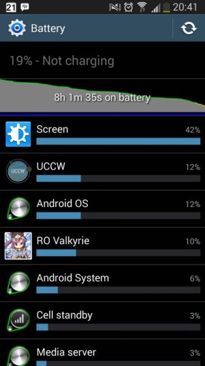

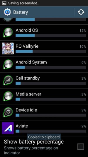

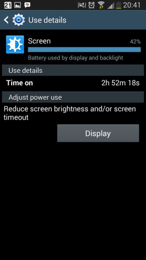

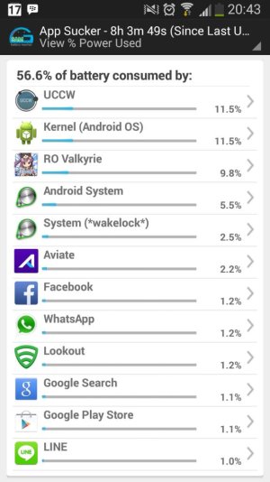

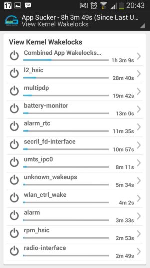

Here's another screenshots, my brightness is always auto and -5.
I realize my phone getting hot when it searching for signal. I hope you can find my phone problem. Thank you

I'm not sure what auto and - 5 mean in tandem. I don't use the auto setting; unless I'm outside I pretty much always have the screen at minimum brightness. You can look at this screen in GSam to better quantify your screen brightness.
And if you look at the bottom of the main screen you'll see what kind of Screen On time you're averaging.
Your data shows that you had almost three hours of Screen On time, which is fairly good for this device.
You can look at this screen in GSam to quantify your cellular signal.
The lower the signal, the more power the phone will be using to search for/maintain the cellular signal.
UCCW stood out as a big consumer in your list - you probably want to look at the details for that app to see why.
And if you can do without Mobile data or Wi-Fi while playing games you can try that. If that game causes the phone to get hot it means that it's running the CPU & GPU at higher frequencies, which means more power loss. You could try playing a nice calming text adventure.
Overall I don't see anything (other than UCCW) that stands out, and a Screen On time around three hours is good (I managed to squeeze 4 hours out a few times). Try setting your brightness to manual and minimum (I use Display brightness http://market.android.com/details?id=rubberbigpepper.DisplayBrightnessPro to easily adjust my brightness level) and see what happens.
Sent from my rooted, debloated, deodexed Sinclair ZX-80 running CM -0.001 using Tapatalk

Thank you once again! Then I think my mistakes that my phone could go for 5++ hours screen on time haha.
I already delete UCCW so let's see what'll happen.
