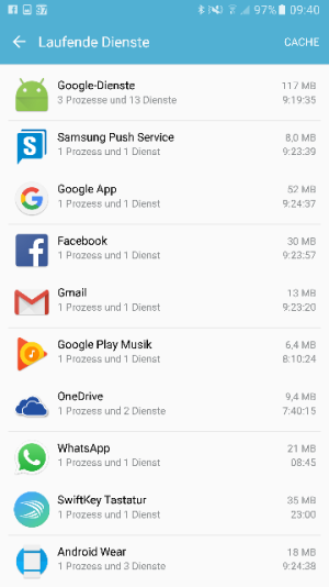

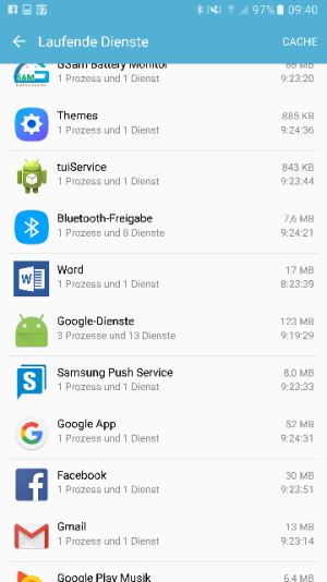

Go to developer options then running services. Screen shot that and show us.
Unless you are running high battery apps like games you should be getting way better battery. I get about 14 hours of medium usage.
Are you running battery saver apps? Sometimes freemium apps run GPS or background data.

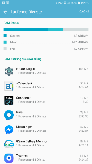

These are the running apps:
