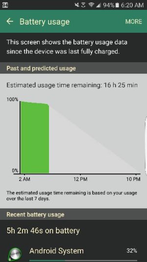

Battery stats:Android system 50%, Screen 10%

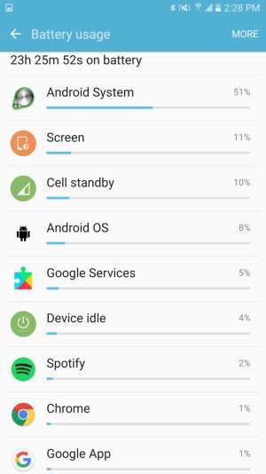

What gives with that? That's ridiculous! I've seen some threads on other forums and such about this but no real solution. Does anyone know how to fix this? I am still getting over 24 hrs on a charge but it should be soooo much better. Could it be my smart watch? Seems like others are having the same issue though without a watch and I didn't have this drain on my htc m9 with the watch.

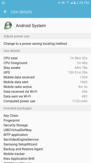

Close your location or choose battery save mode for location that drain your battery.
I think I found the main culprit. It was the always on wifi. Android system is still high, but I've seen a lot of others with it in the same realm as I am now. It's at about 18% these days instead of 50+% just from turning off wifi on while sleeping.
I didn't expect this to be such an issue since on other phones I've always used wifi keep alive which literally does the same thing with little to no effect on battery life.
Could be. I have it fairly locked down and not too many apps. But, there hasn't been any increase in data usage and I haven't noticed any adverse effects from turning keep wifi awake off so I'm happy.

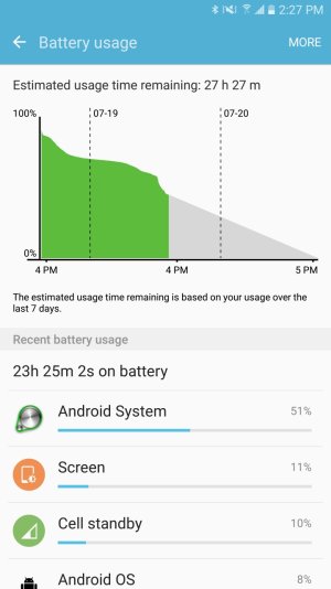

You are getting over 2 days? What is wrong with mine?
