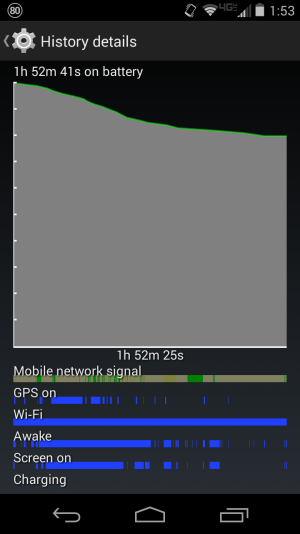

Searched around but didn't seem to find this specific issue in the forums.
So let me start by saying I'm getting great battery life, no issues there. The problem (if you can call it that) I've noticed is that in my battery stats menu, it always shows Wifi as being on, even when I've turned Wifi off and am not using it.
The example below is from this morning. Phone came off the charger at 100% battery when I went for lunch at noon (I actually turned Wifi off in the settings at this time), at around 2PM I looked at the battery stats menu and noticed that the bar representing Wifi is solid blue for the entire reporting time, which to me means the phone thinks Wifi is on (or connected? Not sure what the blue represents) the whole time. Everything else seems to be fine, GPS, Awake, Screen times seem accurate. I was using maps and Yelp a lot so the battery drain and GPS times seem normal.
Anyone else notice this or am I missing something? In my settings I have Wifi set to stay on during sleep, but that shouldn't matter because my phone wasn't "sleeping" most of the time anyways.

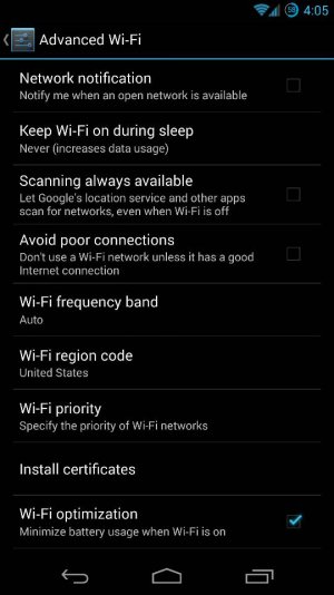

I had this issue with SlimBean ROM. Not sure what fixed it but I have "WiFi always on during sleep" unchecked, and the "Let Google scan for available WiFi networks" also unchecked
Here's what my advanced settings look like
Sent from my SGH-M919 using AC Forums mobile app

Uncheck the setting below that one, "Scanning always available. Let's Google's location service and other apps....., even when Wifi is off."
Thanks for the tips! I missed that setting but just checked and it is off already. I'll try toggling WiFi sleep over the weekend and see if anything changes. I like to leave it on at the office because I am up in the mountains and while I do get LTE, the signal isn't always strong. Like I said, it doesn't seem to be affecting battery life, which has been great for me, so I'm not too concerned.
