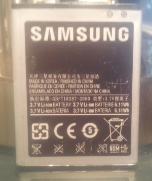

I have been having troubles with the phone not booting - sometimes dead, sometimes that loop between gray empty battery symbol followed by green battery and going back to gray and so on...
I checked the battery voltage with the voltmeter and got a reading of 5.32 Volt
Is that the problem ? Shoul the batteries not be at 3.7 V or 4.0 max ?
Something wrong with the (external) chargers I am using ?
What says the specs that are printed on the battery?
You might load the battery with a resistor while measuring.
It reads 3.7 V 6.11Wh
