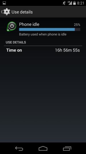

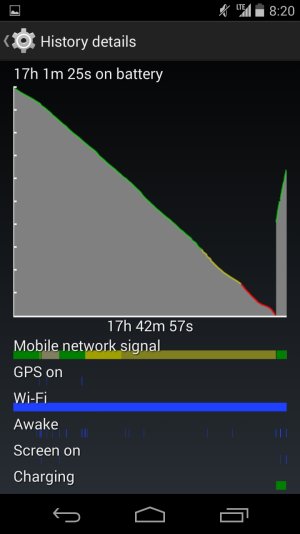

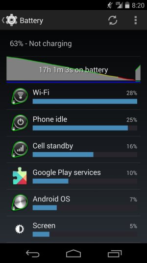

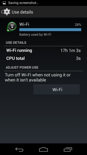

Unplugged my phone after work and when I looked at the % it was full charged at 100%. I did not use my phone at all last night or this morning. When I woke up it was dead. I turned it on and it shows 17h 0m 0s on battery of which Wi-Fi was the top user of the battery at 16h 59m 59s. I did not have Wi-Fi on during this time. The next on the battery list is phone idle 16h 57m 7s.
Any ideas what is going on here? How is Wi-Fi draining my battery if it isn't on?
Edit: Just to add some more info. I started charging it 20 minutes ago and it was at 20% already (it said under 1% when it finally turned on). I rebooted it at 20% and when it rebooted it showed 41%!

Go to Settings>Wi-Fi, tap the menu button, then Advanced. Make sure "Scanning always available" is unchecked, and change "Keep Wi-Fi on during sleep" to Never, if you haven't already.
Thanks. I've made those changes. If this doesn't work I'll try uninstalling some apps.
