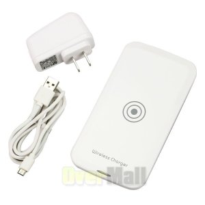

I have two Tylt VU chargers and another cheap QI wireless charger that I bought on eBay.
My VU charger is silent (no beeps) but on the other hand it wakes me up in the middle of the night by making my phone to turn on the display and vibrating when is completely charged.
The cheap QI charger works great. The way it should. It beeps only when I put my phone to charge and that's it.
So you should definitely choose your QI charger carefully before you buy it.

SORTED! And it's very easy.
Turn the charger upside down and remove the cover using a jeweller's flat-bladed screwdriver or two. Identify the speaker - with the connector towards you it's a black 7.5mm square block, centred 20mm away from it and offset to the right. It has solder points at each corner. You'll see a slot facing towards the LED. Insert a jeweller's screwdriver into the slot and flip the lid off. Inside you'll see the metal diaphragm, remove it and replace the cover - or chuck it out along with the diaphragm.
For those who complain about it beeping frequently, it's likely that the phone isn't square on to the charger. You won't get this warning after defeating the beep. While the LED turns from green to blue when properly aligned, the phone hides it from a normal viewing angle so you need to be able to place the phone in a fixed position on the charger. Blue-tack the charging pad in a position where you can place the phone aligned with a back and side wall or something similar.
