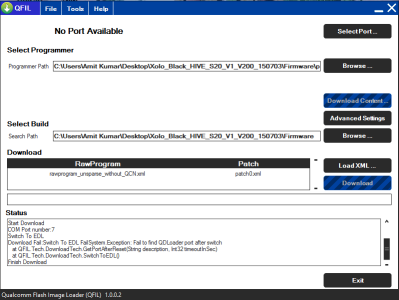

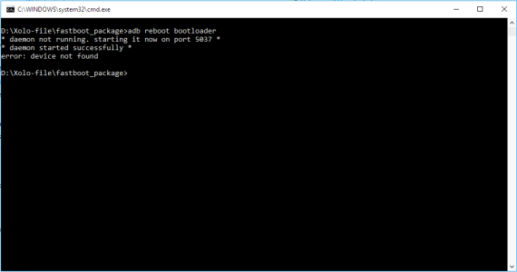

After hard reset (User date delete/Factory reset) My XOLO Black (2 GB RAM) screen goes to black. but, Charger light also glowing as green and as red when charging. (ROM Installed - HIVE Developers ROM - V 2). Many times I tried to Flash Xolo Black Official Firmware through their Instructions. When I trying to flash The ROM, Qfil flash tool showing "No Port Available". for your better information I attached Screenshot. any solution for recover the black/blank screen? any one can help me pls.? I also tried to fastboot / recovery flash. but, there was shows as error. "Device is offline or waiting for device"

This is because you're posting in a very old thread (from 2011) about a very old phone (the myTouch 3G Slide), which isn't even the phone that you have. I suggest you create a new thread with your question in the General Help or Ask A Question forum. You'll have a better chance of getting a helpful answer there. Good luck!
