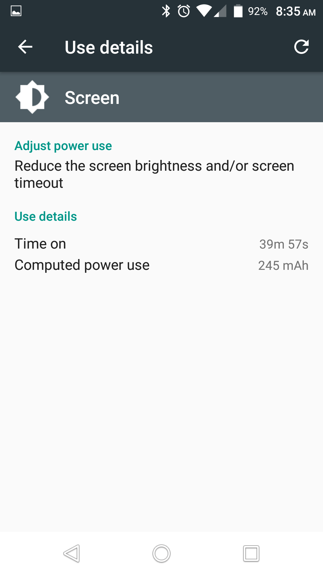

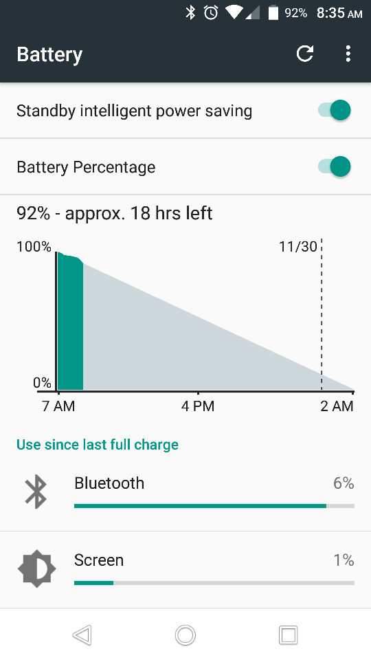

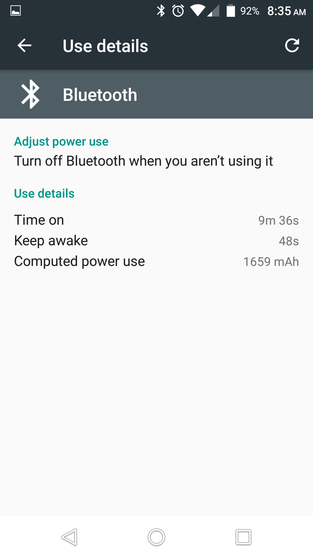

Here are some pics of this mornings usage for context.
Any ideas?
The computed power consumption of bluetooth is super high for some odd reason.

I have one of these phones too. It's definitely a bug in reported usage (and not actual usage). Maybe off by 100x and someone missed a decimal place? Or even 1000x and someone mixed up mAh and Ah
I'm currently at 87% battery, and the phone has a 3000 mAh battery.
Which means only around 390 mAh total has been used (13% of 3000), but it's claiming my Bluetooth has used over 1200 (or 40%) of the total battery.
If the reported numbers on usage were accurate, it'd mean the had a battery equivalent to a medium sized powerbank.
In your screenshot, the Bluetooth "used" over 50% of the battery, but only drained 8%.
