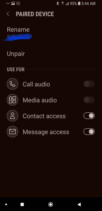

It's all about the profile that the device connects to. If the PC connects to the headset with both Audio and Phone (or headset for a PC) profile, then the phone functionality is taken away on the phone. When you disconnect from the PC, your phone probably isn't returning the Phone profile to the phone itself, so you gotta do it manually.
If you don't need the headset/call function on your PC, you can manually turn that profile off on the BT Settings of your computer. Maybe that will help your phone keeping the Phone profile active even if you connect to the PC.
The above post referred to this screen.
