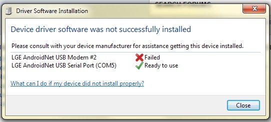

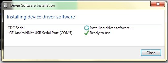

hi, I have the exact same problem as OP. Only actually it's a tad worse as I cannot, for the life of me, get the CDC Serial drivers to install.
I have uninstalled all my (old) phone drivers etc, and ran registry cleaner. I have then installed 3.8.1 driver via LG Mobile Support tool.
If I could get either the MTP driver or the CDC driver to work I could access the phone.
I've found this website where you can download the CDC driver ( CDC Serial Drivers Download for Windows 7, 8, XP, Vista ), but I don't know where to put them.
For now it looks like this:
Anyone have an idea how to get CDC working?
