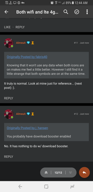

It truly is normal. Look at mine just for reference... (next post) :).
As you can see Verizon shows the same thing.

Not fully true. If it's white instead of greyed out it's still using WiFi it just means it's active / on standby.
Usually if it's active while on wifi it means there is an app holding it. Fabris do you have a caller ID app you use with AT&T? Usually caller ID apps need the mobile network to ID so it will keep it active (or white) but it shouldn't use data until a call comes in. Even then it would be a very minor amount to just ID the caller.
Usually if it's active while on wifi it means there is an app holding it wifi. Fabris do you have a caller ID app you use with AT&T? Usually caller ID apps need the mobile network to ID so it will keep it active (or white) but it shouldn't use data until a call comes in. Even then it would be a very minor amount to just ID the caller.

Second.. mine used to keep the LTE icon white (active) when I had the caller ID app enabled since it needs the mobile network to ID. After disabling it and rebooting the icon now goes grey (inactive) as shown in my screenshot.
I promise you it's using WiFi. This issue isn't new and came around the S6 release. I've dealt with it a bunch ;).
