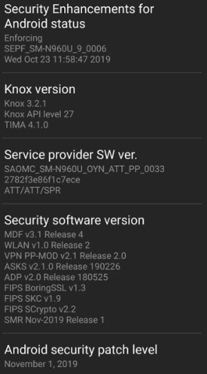

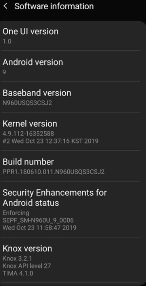

Can you go to settings >scroll to about phone >software page , can you get a screen shot?
Yeah thats a sprint phone .
You can flash through odin to get latest up to date software

The other issue is when you get it unlocked a carrier firmware so it works with other network providers, but it's also supposed to configure each sim that goes on , so if you put the att sim its supposed to have the att splash screen when you start up , its bloatware etc...
Have to be careful as how they did the unlock could come back and relock the phone if they didn't do through proper carrier unlock , ive seen those issues.

You would have to flash Att firmware , now here's another catch , Att firmware been hit or miss for getting updates so either your going flash to the next one or get OTA . Going to att firmware should wipe the sprint stuff and put att on it but if it was unlocked properly it would have done this with the sim card .
What is really weird is the phone does have the At&t splash screen when it starts and it for sure has At&t bloatware. However, I think it might be too risky for my skill level to deal with flashing and the ambiguity of what might happen later seems like a pain too.
