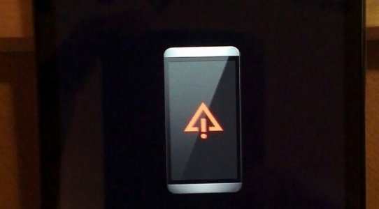

Hi I got OTA update for Marshmallow 6.0 and tried to use the cache wipe procedure but it simply reboots at a black screen with phone with red triangle and exclamation mark (please see picture below).
So I'm guessing HTC changed the cache wipe key sequence that used too work for lollipop because it's not working no more...has anybody had any luck and figured out the key sequence for cache wiping on marshmallow, appreciate any help on this thanks!

OK I got it to work, after holding power and volume down and after selecting recovery you have to hold down volume up and give a quick tap (NOT HOLDING DOWN) to the power button to get to cache wipe options!

I'm having this problem as well. After choosing recovery, it shows the same image (a phone with a red triangle & exclamation point on it's screen) as you (the OP) described. This started happening right after I received the OTA update for marshmallow (v6.0) & Sense 7. Before the update, it rebooted straight to the recovery mode after being chosen in the boot menu. I tried what you said, bit it didn't work for me. Is it a timing issue as to when the new button sequence has to be done after choosing recovery mode? Do they need to be pushed BEFORE that image comes up, or after? I've tried both ways, but maybe my timing is just a little off. I just would like to have some clarification on when exactly.
Any help is greatly appreciated.

I would try again, but be as quick as possible. The quick tap is probably exactly that...very quick.

Do you continue to hold the volume up button until it enters the options or do you release it after the quick tap? I can't seem to get it to work either way, just the red triangle and eventually boots up.

You will now see a screen with a picture of a phone with a red exclamation mark on it. Press in power button, keep it pressed, and press volume up button shortly (do not keep it pressed). Release power button.
You will now see a menu with yellow text on-top of it.
Select Wipe Cache partition with vol down. Press Power to select. Now it wipes the cache partition. Done!
It should now have marked Reboot system now. Press Power to select. Phone will now reboot to normal mode.

Sometimes I hold power and quick press to vol up, sometimes other way around and sometimes quick tap together works...I do button mash of all three and I get there in the end...maybe someone can make a YouTube video that would be nice.. I wish HTC hasn't made this timing sequence so tricky...

Thanks, that worked and was easy. Marshmallow sure made the phone quick again, I like it.
