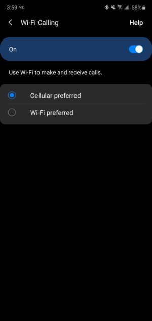

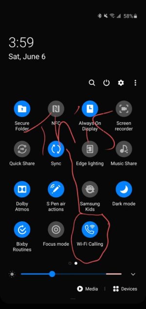

Not wifi apps , in pull down notification panel toggle for it , is it off?20200606_160051.jpegScreenshot_20200606-155953_Wi-Fi%20Calling.jpeg

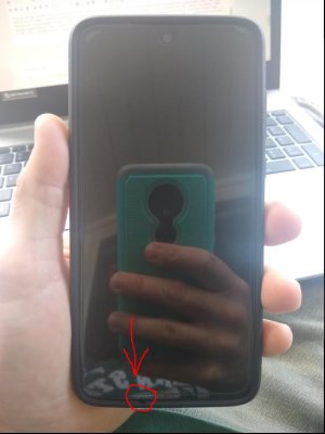

the hole at the bottom of my screen on the front of the phone (see attached picture) seems to have some effect covering/uncovering...but i assume that is the primary mic? not sure why it would make a difference while using speakerphone, since the same mic should be used. as for removing the case, tried it, no effect. both phones can cycle speaker on/off, no effect. also...i CANNOT locate any noise reduction settings anywhere in my phone, searching doesn't help, google search doesn't help. everything i find online tells me to click on settings options that DO NOT EXIST on my phone. anyone have experience on MY EXACT PHONE MODEL? motorola moto G7.
i don't have that option in my pull down menu, including when i edit it to see all the available options. maybe it's not available on a moto g7?
Ok possible also your carrier don't support it on that phone also.
