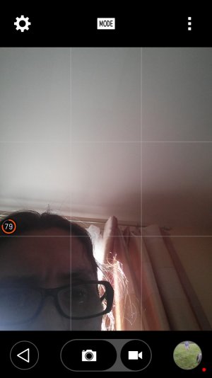

Hi. Very interesting problem here. My camera on my LG G3 is stuck in a selfie mode and there is no options to flip it back to my main camera. Any solutions for this?? Thank You

Secondary there, showing me a picture
Primary not there...
