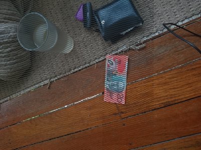

So this is my brand new xperia z5C something definitely wrong here i think only had it one day. Any ideas? Doesn't happen all the time however most of the time it is. Cant see anytihing in the forums with this same issue. Plus its getting rather warm on the backside.
tried diferrent resolutions,
tried updating the android version,
tried factory reset,
apps like snapchat and a free camera app worked fine.
thought maybe it was caused by memory shortage with lots of apps open. closed it still happens.
Cheers.
Ben
It's a strange software glitch mostly as other camera apps work fine. Did you try clearing stock camera app cache and start fresh?.. also make sure you are running the latest firmware. 152 or. 200 in some regions.. lastly you may try running pc companion and perform a repair

Hi, Thanks for the reply, I will try find out the firmware and update if possible. One of the free apps is also doing this also. Mine is black/grey-black and bought in Australia. Pretty annoyed. everything else on the phone seems to work pretty sweet but this is obviously a problem.
That is odd... 1st time I've ever seen this from a Sony camera. I am on Firmware .200 and there was also a recent camera update in the 'What's New' Sony app. I'd try a factory reset as a last resort if the other suggestions don't work. If all of these fail to resolve the issue then you might have just gotten a defective device that needs to be replaced.

Got hot just setting up apps I think. And possibly playing with camera. Shop where I bought it said to try hard reset. I had already tried factory reset.
Hard reset I think is power and volume up. Vibrates 3 times goes off. Someone else speaks of using pc companion for it but seems like rubbish.
If the camera issues continue after trying all that then I'd say you have a defective unit that needs to be replaced..
