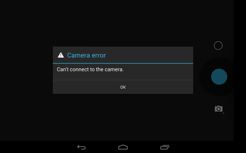

I used the camera once with no problems. The next time I tried to open the camera app, I got this:
Has anyone else gotten this error?
http://img.tapatalk.com/d/13/08/01/a3erapyv.jpg

I got an error saying that my camera would not work, because no external storage was detected. Reboot fixed it, and I never came across it again.

The next morning there was a update. So I updated and had o problems since. Are you guys still having problems with it?
I restarted today and now everything looks normal. Restarting yesterday didn't make a difference, so the problem may have just sorted itself out.

I had the same problem out of the box...after an upgrade to 4.3 (apparently mandatory) and a few reboots later; it has been all good now.

I had the same problem. Upgrading the OS fixed it. Make sure you get the current version by doing an upgrade when you first receive your Nexus 7. As of today the Build number is JSS15R. Go to SETTINGS>ABOUT TABLET>SYSTEM UPDATES to check your current version. Have Fun!
