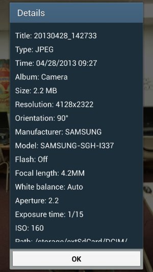

Specs on masked man photo.
Sent From My Galaxy S4 Using Android Central App

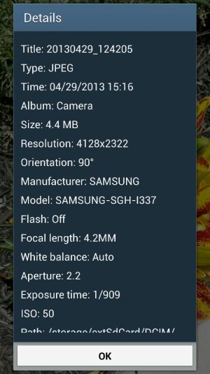

Specs on the flower image.

Thats it. Look at Exposure time: 1/15 sec. VERY slow for handheld AND the flash didn't fire. The slow shutter speed of 1/15 allowed "normal" camera shake to blur the image. ISO was 160. Easiest thing would be to make sure the flash fires when indoors. Increasing the ISO setting makes the meter more sensitive to light so the camera will choose a faster Exposure time (shutter speed). Faster Exposure Times freezes action/camera shake more. Another possibility is to shoot in Shutter Priority mode and choose 1/90 or 1/125 sec as a minimum speed.
Have no fear this is a very good camera. Its a tool. You just need to practice for different situations so the camera records the image/exposure accurately. Thank goodness its digital so we can simply delete them.

The flower shot looks good. MUCH higher shutter speed (1/909 sec) and the camera dropped the ISO to 50. It looks good to me. Lots of contrast. The HTC One shot looks a little washed out/over exposed to me. Flower colors are very similar. Usually the lower ISO speed gives the best possible shots. Camera will fluctuate the ISO and shutter speed to compensate the exposure since the lens has limited aperture settings. Both shots the aperture was f/2.2.
