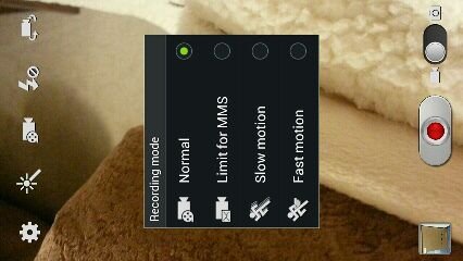

I just started taking some video the other night and got annoyed that every time I either switch to video or an on video mode and open the camera app, I get prompted to select the recording mode.
I'm not positive but I thought this didn't happen on my first phone or on 4.1.1-but I don't remember if I tried videoing for sure.
Does everyone else experience the same?
Sent from my SAMSUNG-SGH-I317 using Tapatalk 2

I'm on a 4.1.1 ROM for Verizon and my phone does this all the flippin time. It's annoying to the power of 10. No clue how it started or how to fix it. Thinking about wiping data for Camera app and see if that helps.
International Factory Unlocked, 4.1.2 stock ROM, it doesn't ask for that... I'd try to clear data/cache from the camera app and see if it helps (just remember to re-set your preferences as this will probably reset everything to default values, including shortcuts).
Clearing data did not fix it. Very frustrating. Wonder what could possibly be causing this?
I'm on Sprint with the latest update and mine did this before and after the update. Yea i would turn that off if I could but it's no big deal.

Mine has done that from day 1 right out of the box. My phone runs perfect. No issues at all, I would not do a factory reset for for this. I'm thinking if that's the way it worked out of the box then I'll just wait for an update to change it. It really does not bother me at all. Only does it when opening video..

Yeah, it's really just annoying. I don't video a lot but did some of my daughter at tumbling the other night and couldn't figure out why it kept prompting me. All of the other settings either for camera or video seem to remember their setting.

OP, I have some good news and some bad news for you.
The good news is I found a way to disable this from happening! The cure is as simple as changing a line of code from saying "true" to "false"
The bad news is it requires you have root in order to do :(

You need to open up your feature.xml file in the following directory:
/system/csc/feature.xml
And modify the line near the top of the <Camera> section that reads something along the lines of "Popupvideomode" or something or other, and find the part where it says ;"true" and change it to "false." Save the file and reboot. It no longer will ask you what video mode to use when you open up the Camcorder.
