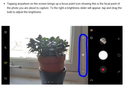

There used to be a light bulb slider that would allow me to change the brightness of a photo before taking a picture with the camera app. I tried to use it today and noticed that slider has disappeared. Does anyone know why it's gone? Can anyone help me get it back?
Here's a screenshot I took from a website (Samsung Galaxy S8 Camera User Guide Tutorial: How To Get The MOST From It | Know Your Mobile) explaining how to get it and how it works, it no longer shows up for me in my camera app. Please help! CameraBrightness.JPG
Here's a screenshot I took from a website (Samsung Galaxy S8 Camera User Guide Tutorial: How To Get The MOST From It | Know Your Mobile) explaining how to get it and how it works, it no longer shows up for me in my camera app. Please help! View attachment 265850
