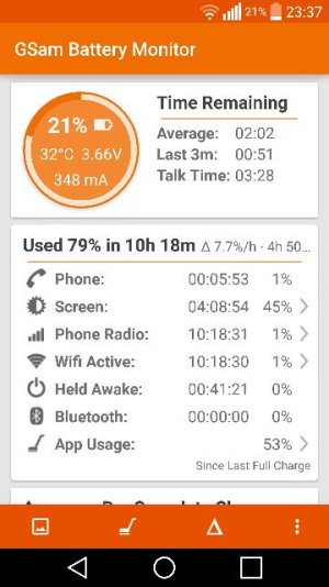

Re: Help with the battery life!
I was able to get this completely stock.
