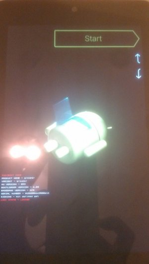

Hi
I installed the Nexus Root Toolkit v1.9.4 onto my PC and followed all the steps to update my kitkat Nexus to 5.0.
All was going well until 1 minute into my Nexus getting updated my battery died and it powered off (I didn't realised I was on 3% or so battery). So now when I switch it on I can’t get passed the fastboot mode screen and nothing gets found when I plug it into my laptop. Also when I try to re-run the Nexus Root Toolkit v1.9.4 it says it can’t find the ADB.
Is there any way to save my Nexus 7, screens attached
You can DEFINITELY fix this.
Is this the Nexi7 2012 or 2013?
I have all files saved for the 2012 on my desktop at home (currently at work).
I could post them later for the fix.
If it's the 2013 I can look into it for you :]
Thanks for the response Its the 2012 Nexus 7
Any help will be appreciated
Sorry to get back to you so late!
I've uploaded the files to my Drive, and I'll post the link at the end.
I found these instructions: Click Here
Not sure if they go with the exact files I have uploaded and used, but I assumed that some general instruction might help!
I also found this information as well.
[URL="https://drive.google.com/folderview?id=0B5zs6S07Ic8Ia3RxTHRFMnh5VEU&usp=sharing"]Here[/URL] are the files I've uploaded! Again, I've used these myself to fix my Nexi7 when it got bricked updating to Kit Kat.
If there's anything else I can do, please let me know!
Also, please let me know if these files don't work out for you!
Your a god damn life saver
:D
It worked and my Nexus is up and running again thank you so much, i got lolipop up and running on it as well
