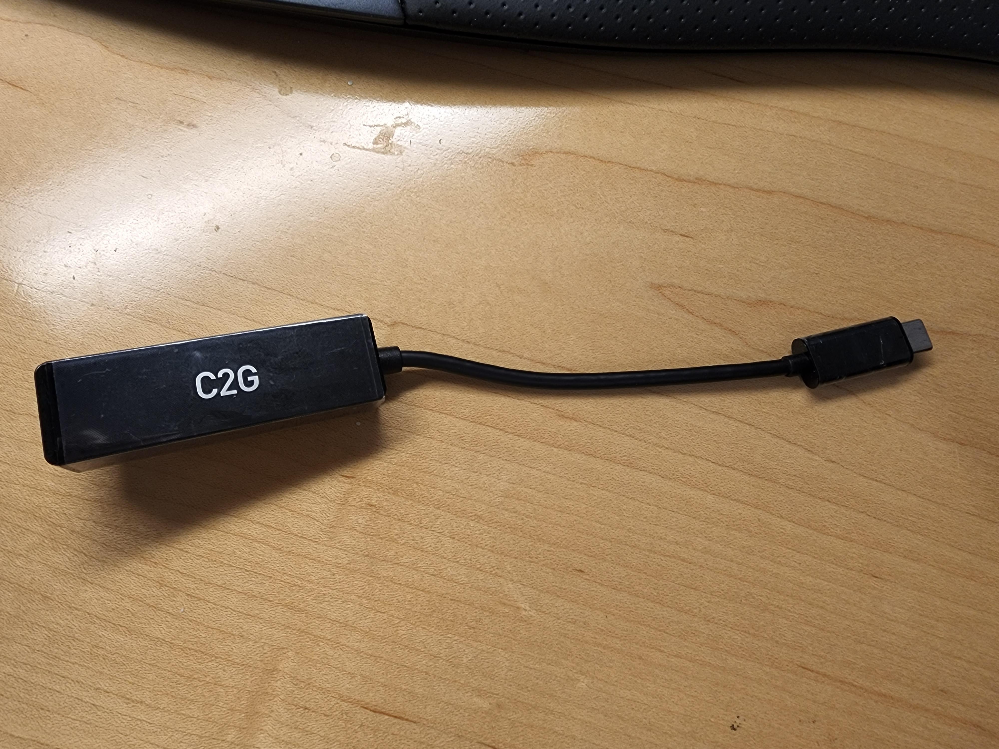

Do a search for USB-C to ethernet adapter. They range from about $10 to $20. I got mine yesterday and it works. There's lots of them at Amazon.
So I just tried this at the office with a Cables-2-Go USB-C-to-Ethernet adapter and was successful, which surpised me. Settings-->Mobile Hotspot and Tethering-->Ethernet Tethering.
