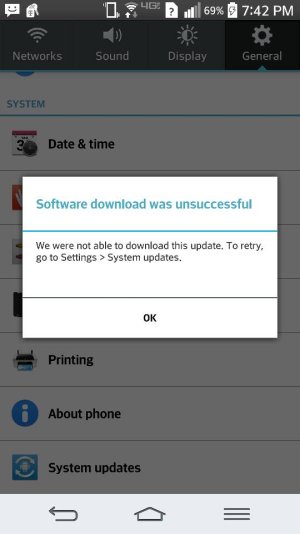

im using a verizon lg g2 on tmobile and i was curious to if i can still recieve updates or not. Android 5 is comming out and I want to upgrade but not sure if it will work, when i go to system updates and check it says software update unsuccessful go to settings>system update and try again. my phone says its rooted, however theres no root access on it. any reason why this is?

You will not get updates without active Verizon service over the air. You might be able to use the Verizon update software updater, or just wait for the KDZ/TOT file and flash with LG Flash Tool.

when it connects to my computer, i open the vzw software manager and nothing happends. I figured it was just because I dont have verizon service, but when android L comes out wont that be pushed by lg so i can get it?

You have to use Verizon upgrade assistant. Look for the program to pop up when you first plug in your Verizon branded device to your pc. Once it installs it will check if a software update is available.
