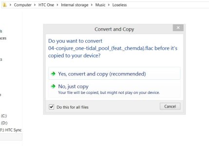

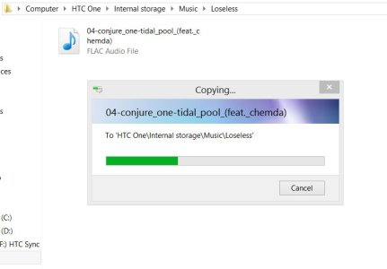

I am not able to copy Flac audio files from my PC to the Internal Storage of the HTC One. When I paste the Flac files into the phone, it prompts for file format not supported, then I click 'No, just Copy' and for all files. But then it only copies the first file (If I selected multiple files) and then freezes. When I cancel the process, the first file is copied successfully. I am using WIndows 8 and had same problem on WIndows 7 also. Anyone having the same problem ?

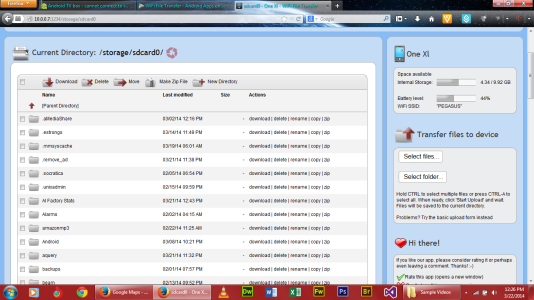

Hello! Try this out. Download Wifi File Transfer on your HTC One.
Open it.
Click on the start button.
It will display an ip address.
Go to your PC.
Enter the ip in your browser.
You should get an interface that looks like this. This is your internal storage.
You can upload files to your phone this way.
Hi, thanks for the reply. I have the Pro version of the Wifi File Transfer, its a great app and I am currently using this method, but the problem is it is slow compared to wire transfer as Flac files are very big in size, ~40-50 Mb per song/ ~400Mb per album. Is there any other method to copy Flac through data cable ?
