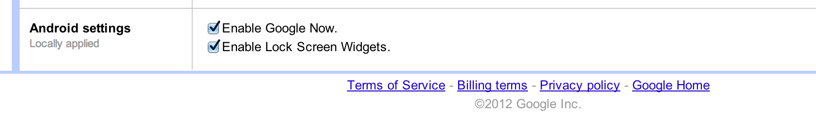

...so the issue is whoever controls your business email system needs to actually *enable* the lockscreen widgets in Google Apps for Domains administrator mobile options. Way down at the bottom, in a section with the option to enable Google Now.
I was in the same boat as you re: lockscreen widgets on my Nexus 4 until I dug down into my Gapps settings and found the above. Enabled it and everything works wonderfully.

This is not a bug and it has nothing to do with using a pin. As a Google apps administrator, I can confirm that this is being cause because of a google apps device policy. Unless you can remove the account that requires Google Apps Device Policy to be installed, you will not be able to add widgets to your lock-screen.

This is not a bug and it has nothing to do with using a pin. As a Google apps administrator, I can confirm that this is being cause because of a google apps device policy. Unless you can remove the account that requires Google Apps Device Policy to be installed, you will not be able to add widgets to your lock-screen. Screen Shot 2012-12-15 at 10.30.17 PM.png
