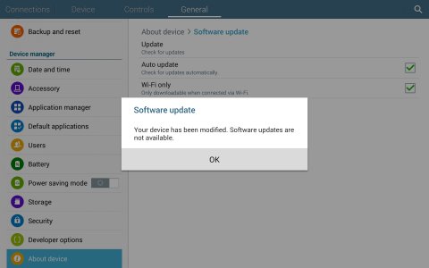

Tried to check for a software notification on my newly bought note pro 12.2. Had a popup window saying my "devise has been modified. Software updates are not available". Anyone got similar problems or know anything about this? I definitely didn't do anything unusual to my devise and I know nothing about rooting.

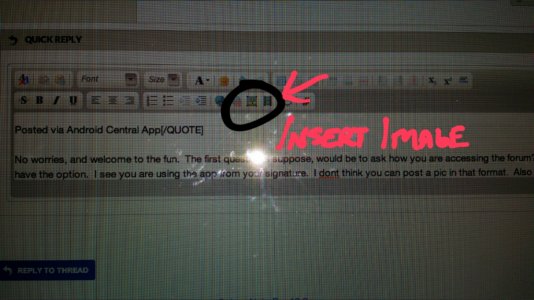

Also... How do I post a pic here.. (sorry daft question but i'm completely new here)

No worries, and welcome to the fun. The first question, I suppose, would be to ask how you are accessing the forum? If you are using a pc- the reply area where you type will have the option. I see you are using the app from your signature. I dont think you can post a pic in that format. Also the app tapatalk will allow it too. If you can just report on what you show on screen that would be good. 2014-02-25 10.06.23.jpg

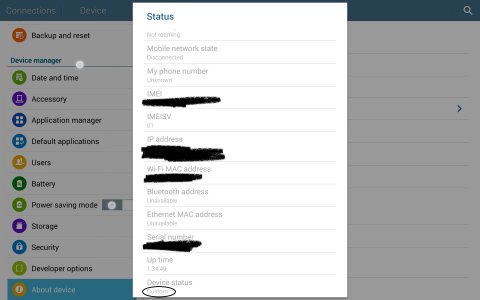

I just used Samsung Kies to connect to it to check for updates and it says I have the latest fimware. PDA:NAF / CSC:NA9 / PHONE:NA7 (XSP)
Called Samsung Hotline and they managed to remote login to my Tablet to check things out.
He confirms that the software version are correct but I shouldn't see the messages as shown in pictures attached.

Thats interesting. Custom from samsung.....but not really. Nothing an update cant fix....if you could. What are they doing for you?

Ok everyone, just got my Note Pro back.
Here is what was confirmed and discussed with one of the Duty Manager at the Marina Square Service Centre.
1) They have reflashed another rom into my note pro and its still has the same issue with custom device status and modified software.
2) Though they say that they have flashed the latest and same rom into my device, I do notice that it is now a Singtel rom as it has some Singtel apps there.
Mine was previously XSP but now its SIN when I look at the Samsung Kies. It is also showing SEPF_SM-P905_4.4.2_0004 for the SE for Android Status. I can't remember what it was in the XSP rom.
3) They have informed me that its a bug and noted on the service report that it is something that they will try to resolve in the next firmware update. I think its their way of saying I cannot solve it now and will need further investigations while not holding on to my device.
4) They informed me that if the software update cannot be done either OTA or through Samsung Kies due to this modified software issue then we will have to bring it back down to the service centre for them to flash it for it. I guess that means its going to be a data wipe of our device. This is going to be very inconvenient!
5) One good thing is that they say that my warranty is still intact as they have other ways to detect if your device has been tampered with. I guess that's where KNOX comes into play. I got them to sign black and white on my service report that its a bug to be resolved in the next update and my warranty is still intact.
6) I have informed them that there are many people with these issues also at the moment with the LTE version and asked if they will have a recall in anyway. I didn't really get a reply on that but I gathered that they are still going to investigate further and hopefully the next firmware update will really fix the bug.
I know this issue might be unimportant to some people but I hope I would have at least helped some confused people out there to clarify that it is now a known bug to Samsung and hopefully they will not start voiding people's warranty next time when people bring their Note Pro 12.2 in for servicing.
