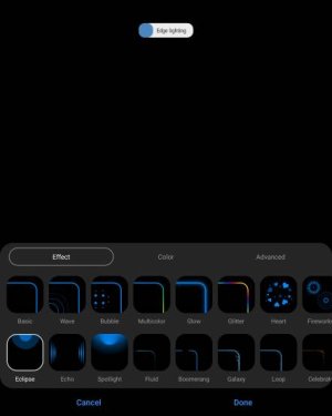

The stock EdgeLighting and I found and downloaded EdgeLighting+ and I still cannot get the camera hole punch notification light to work on either the outer or inner screens. I assume the correct option would be "Eclipse" but when I press it nothing happens?

So I had this working which I though was cool as my Selfie camera(s) would show a clockwise spinning light when unlocking with face recognition or talking a picture.
Wanted to add a different colored light as read you could by downloading the Good lock app you did! No joy! 1. Couldn't get the app in Good Lock; 2. It's called black hole instead of eclipse and 3. Told by the Z Fold2 concierge it will be available the next upgrade (11) with our device... uh huh!

This is where I grabbed the EdgeLighting+ apk, it does add more options but not the notification around the cameras I am looking for. So we should be getting it with the now rolling out One UI 3.0 and Android 11?

Does the settings have the black hole option in a part of the schemes (eg: eclipse)?

So I think I just figured out why my swirling white light around the selfie camera either on the main or outside screen disappeared!
It had been working when I first got the phone then it disappeared... So even though we don't have Edge lighting Plus available via Good Lock to us to control the light color etc, i had that swirling light!
After some thought considering what I had changed on the device, here's what I figured out: under Developer Options I had turned off the window, transition, & animator scaling effects to 0. If put back just the animator setting to 1.0 or 1.5 effect, will now have that swirling light effect! Woohoo
PS: restart is required.

Yup that did the trick for the couple that weren't working in Goodluck, it seems to be the Animator Duration Scale that was set to 0. When I set it to .5 it works now. Great find! Just hope the pin hole notification light will be in the update.
