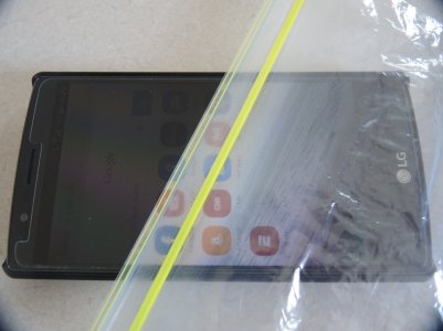

I just tried this myself. I used a common polyethylene ziplock bag, laid over the screen. Then put on polarized glasses to see what it did. If I rotate the bag so it faces in a certain direction, I can once again see the screen in Landscape mode. It happens to look brightest near the ziplock strip. The bag film may be thicker there, the surface is also textured in that area.
If I then look at the screen in Portrait mode, however, the screen looks dimmer near the ziplock strip. So in this particular example, there seems to be a trade-off in how the screen looks in Portrait vs Landscape.
There may be other materials that do a better job of reducing the polarization of the light from the screen. I tried having just 1, or both layers of film in the front of the screen, the results seemed about the same to me.
See the attached pictures. I put a polarizing filter on my camera, to simulate wearing polarized glasses. I oriented the filter so it worked like glasses (bright in Portrait, dark in Landscape). Then oriented the bag to maximize the brightness of the screen in Landscape mode, with another picture taken in Portrait, for comparison.
